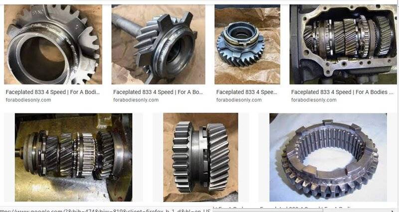

Faceplanting is much more involved than that. Pretty serious ($$$) modification.
I think faceplate refers to what is more accurately called dog tooth gears, the actual teeth are on the gear faces.

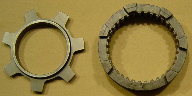

3 of those "face plated trans" pictures above are mine. Here's a pic of the parts I typically use, they are made by Liberty...
The dog ring on the left welds to the gear after the gear's engagement lugs are removed, the faceplate is machined into the side of the slider on the right. There's a lot of lash between the two when engaged, but there's also a lot of lash on a pro-shifted setup. I've even removed every other gear lug and slider spline in a few transmissions, basically the purpose of all these modifications is to widen the window for engagement, which makes it easier to hit that gear's engagement window at high rpm.
That picture on the bottom left above is one of mine, it's a Saginaw 4spd that has a synchro on 1st, every other stock lug removed on 2nd, 3rd is faceplated, 4th has a synchro. I do all my own transmission modifications.

Can you give us some pros and cons of pro shift vs face played?
Faceplate is better than pro-shift, although both shift and drive about the same. Normal wear/tear on a pro-shift creates little burrs on the engagement lugs that can eventually cause a missed shift. Basically the slider will hang up on the burrs. The lugs are usually still good, just need to occasionally tear the transmission down for burr removal. Faceplates don't require that periodic maintenance.
