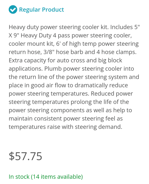

I bought the cooler along with the Borgeson power steering box from Bergman autocraft. I figured better to install it with the new box.
There's all sorts of generic PS coolers for cheap on eBay and Amazon.
