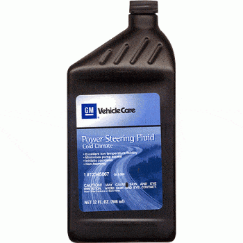

Manual sez on the Federal pump (which sounds like what you have) fill level is right at the bottom of the fill tube. ATF works fine, though there are PS fluids available. One of the best is GM Cold Climate fluid, have stopped a lot of cold operation problems with it.

There is no specific fluid per say?? my fluid is not red.... I just don't want to add the wrong fluid, -Rich
As per the Factory Service manual.
"Powering steering fuild # 2084329 or equiavalent. Caution: Do not use Automatic Transmission Fuild."
I've used ATF to top off when I had to but use Power steering fuild which is clear, not red.
OP, any good P/S fuild should be fine.
All the Power steering fuild that I've seen for the last 40 years is clear. ATF is red. P/S fuild is not the same as ATF.
