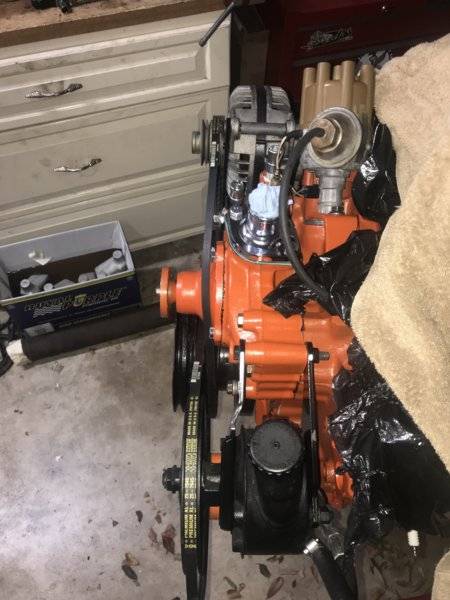

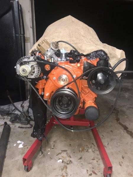

Playing musical pulleys last night. My 440 only has the alternator, water pump, and power steering (no ac). Question: does the power steering belt also ride on the water pump pulley? Trying to determine if I need a single or double groove water pump pulley. If you have one for sale let me know that too. Thanks!
The crank pulley shown is just a mock up as it’s off a sb w/ ac. That’s why it looks so big. I ordered the smaller bb 2 grove crank pulley last night.
Power steering pulley uses the crank pulley, not the water pump pulley.
Keep in mind, depending on what power steering pump you have, you may need a different crank pulley. The big/small or small/big pulley combo could result in the power steering belt making contact with the water pump pulley.
Yup, alternator goes around WP and crank, power steering only to crank. Single groove water pump pulley, double groove crank
