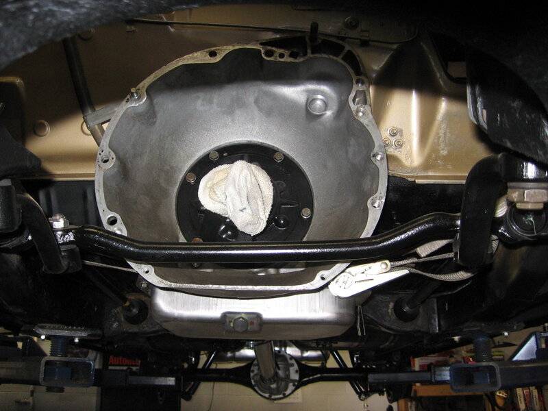

A 1'' ratchet strap works with and without exhaust.
Though this picture is holding the 904 in place you can hook and cradle a short 2x4 across the engine oil pan.

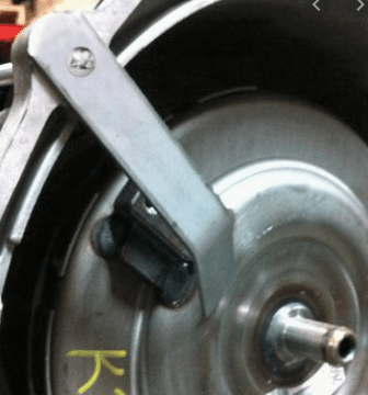

Once the torque convertor is unbolted from the flex plate bolt a 3/8" wrench to the lower bell housing area to trap the torque convertor so it can't fall out....
Picture is of a GM & instead of a wrench they used a piece of metal and they mounted it up high which means it has to be removed at the time when it would actually be useful...But you'll get the idea...
It's a good idea to do something similar to wilds picture when installing the transmission. The torque converter needs to be fully seated before mating up with the engine block. I've used a beam clamp right at the bottom of the bell housing. Worked well.

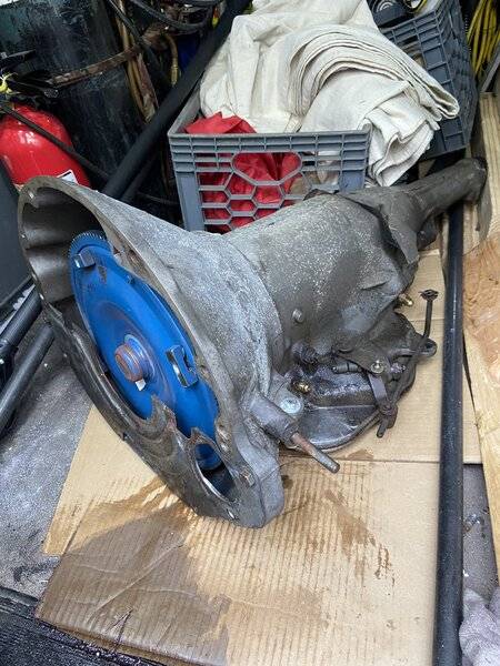

A big thank you to all that offered tips and advice! It went very smooth and with my buddies help we had it out in about 3 hours.
Now it’s off to the rebuild shop.
Good to hear.
That torque converter looks pretty new?
It was supposed be rebuilt when I installed the 340 about 6 years ago. That torque converter is original to the car with 50k miles. I have my doubts on the quality of that rebuild as the rest of trans bebuild couldn’t handle the added HP. Time to have it done right.
