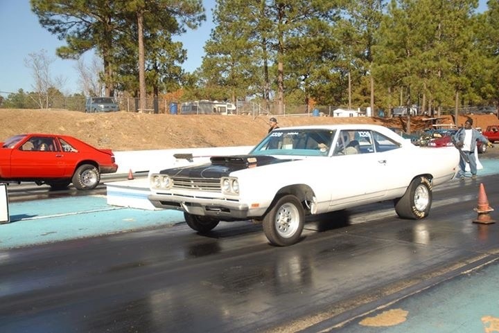

Trying to make this beauty a little faster. Where can I find a cam card for a MP purple shaft .590 SBM cam? I know lift, duration, etc. what I need is spring height etc...
Thanx
