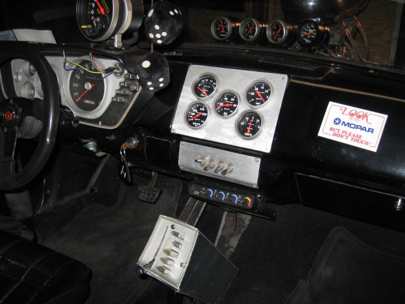

I mounted a '64 shiffter between the buckets and and hookinh fron the sifter is a breeze.IMG_1726.jpg
