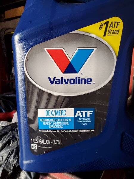

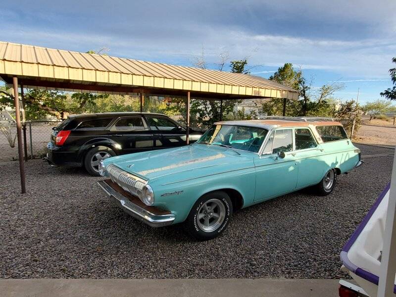

1963 Dodge 330 w/ 318 and T/F 727, is very slow to shift, first drive of the day. Take 1/4-1/2 mile, before it will shift out of first gear, even if I try shifting manually. This just started a couple days ago. After the first shift of the day, there are no others issues. Drives and shifts perfectly.
Fluid and filter were changed about 1800 miles ago, including draining converter. It has been working perfect since that time. Refill was with Valvoline Dex/Merc.
Anyone have any idea what would cause this?
Would a change to Type f help?

Have you checked the kick down linkage adjustment?

Type F won’t change a thing it’s not a miracle drug, it is less lubrication. So if anyone thinks that is a benefit go for it.

I’ve run ATF-4 in my trans for years so wouldn’t think the fluid you’re using would make a difference. Does your ride have the 2nd (exterior) filter on it? When I start my car cold it will shift into D or R immediately, no hesitation and will upshift at around 15MPH. When you start yours will it shift into R or D immediately or is there some hesitation when dead cold? Fluid flow restriction or low fluid could be an issue I’d assume you’ve checked out. I installed a shift kit some 15 years ago and went to a non-reusable filter dropping the OEM filter and have a later era torqueflite TQ in it.
Inline filter has been deleted. It does T/C drain back, so I have always had to let it run a couple minutes to refill converter.
The Dex/Merc is just fine. Close enough to type F. A slow shift when the trans is cold is real common. If it gets normal after a short time, all good.

In order to shift governor pressure has to over come throttle pressure. It fails in manual low as well. That should eliminate the valve body. Assuming the throttle linkage isn't binding anywhere that leaves the governor. It could have screen filter that is partially plugged or have governor sticking. One other possibility is a rear pump issue. When the rear pump gears have been removed they wont shift. So if the rear pump is worn that could possibly cause an issue.

Check your linkage, but I agree with last comment, u probably have a governor that's sticking, lucky u, u don't have to remove transmission to check, just the right tools and watch a few good YouTube videos will explain it all. Good luck.
