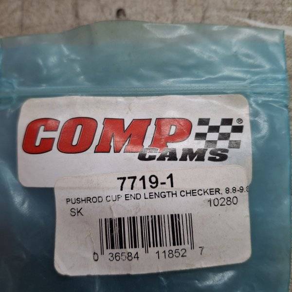

What is everyone running for push rod length. 440. Piston is 10 thousand in the hole. 240 trick flow heads with a 50 thousand head gasket. Solid roller 650 lift
Its better to check what You need vs random guesses. Buy a push rod length checker and check them. CHECK IT, CHECK IT, CHECK IT then buy what you need. There are videos on youtube if you need help checking the pushrod length. Pretty sure stock length is 9.295 in.
[/URL][/URL]
From what I remember, a push rod checker for a stock 440 won't work (too short). The Trick Flow heads are about an inch taller, OP will need a longer one.
