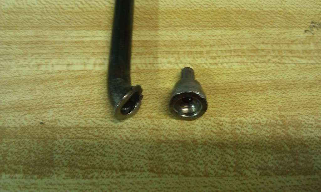

Well I got my motor running with the new intake on it. It was running like crap. It was popping on the pass. side. I pulled the valve cover to check things out and found that I bent a push rod. It also screwed up the rocker arm adjuster. I checked all the others and they were fine but I may just get a new set so I am looking for some recommendation of push rods.

I contacted the guy who built my motor to tell him what happened. He is sending me a new set of pushrods. He put 5/16 push rods in it to start with.:shruggy::thatswck: He is sending me 3/8's this time. He gets them from a place called The Push Rod Factory. If I have issues with these them I will fork out the cash and get some Mantons but for now I am going with the free ones.
