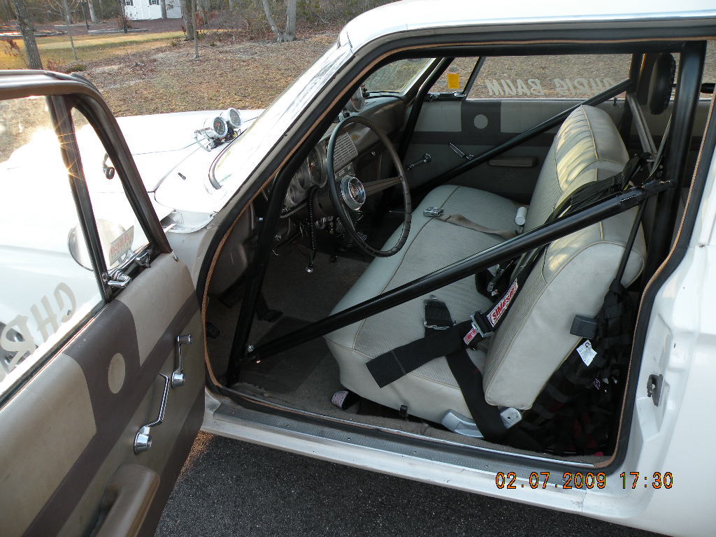

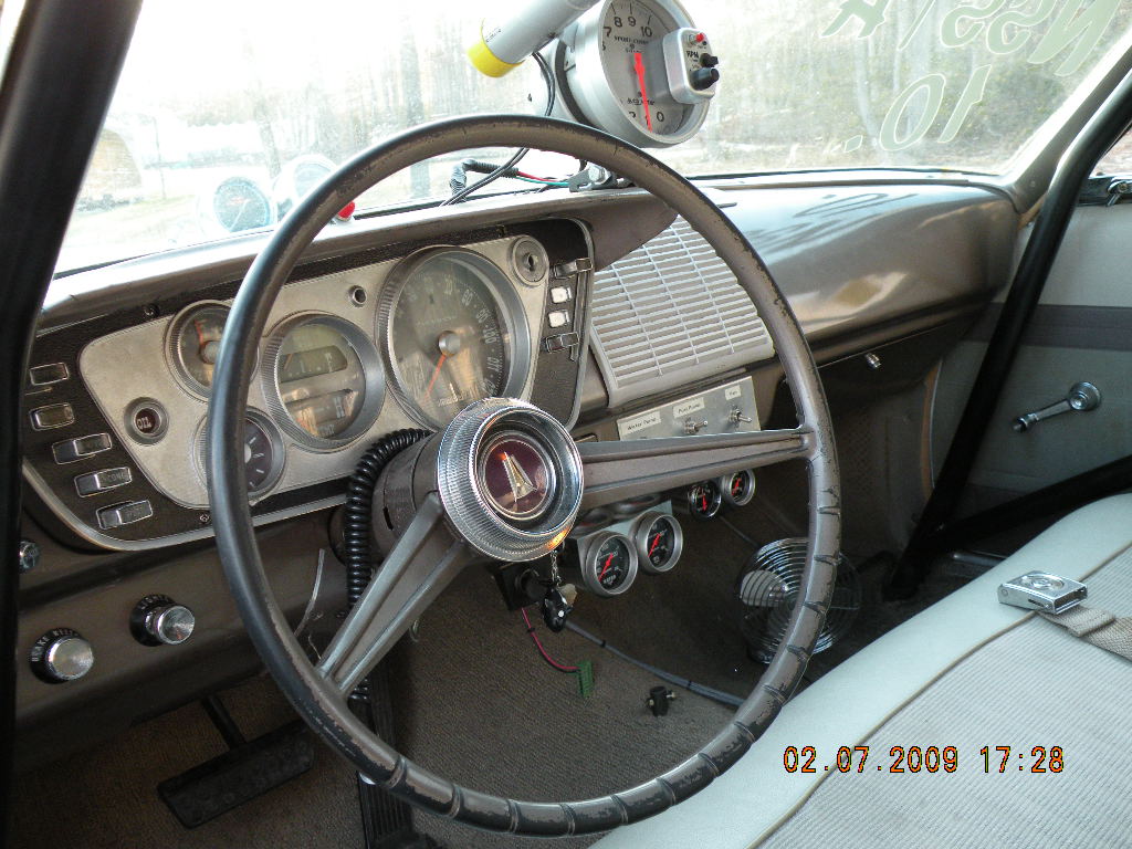

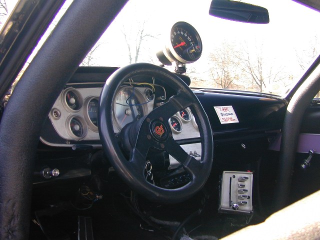

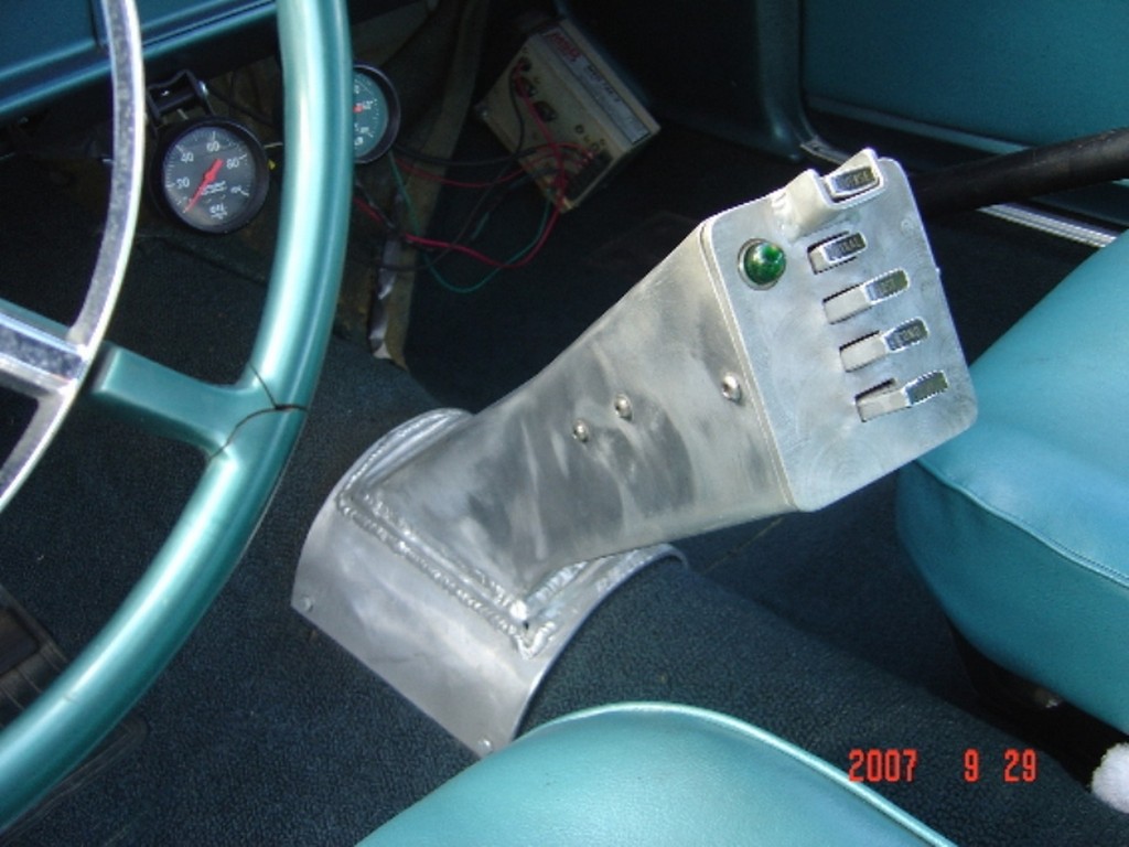

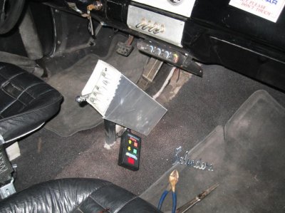

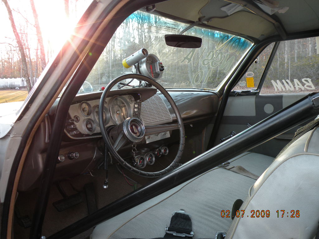

May I ask why you want to eliminate the p/b shifter?????????I will NEVER give up my pushbuttons:icon_rambo:
I have to agree - push buttons are cool. If my car was an auto without the buttons, I'd switch it to a 4 speed.

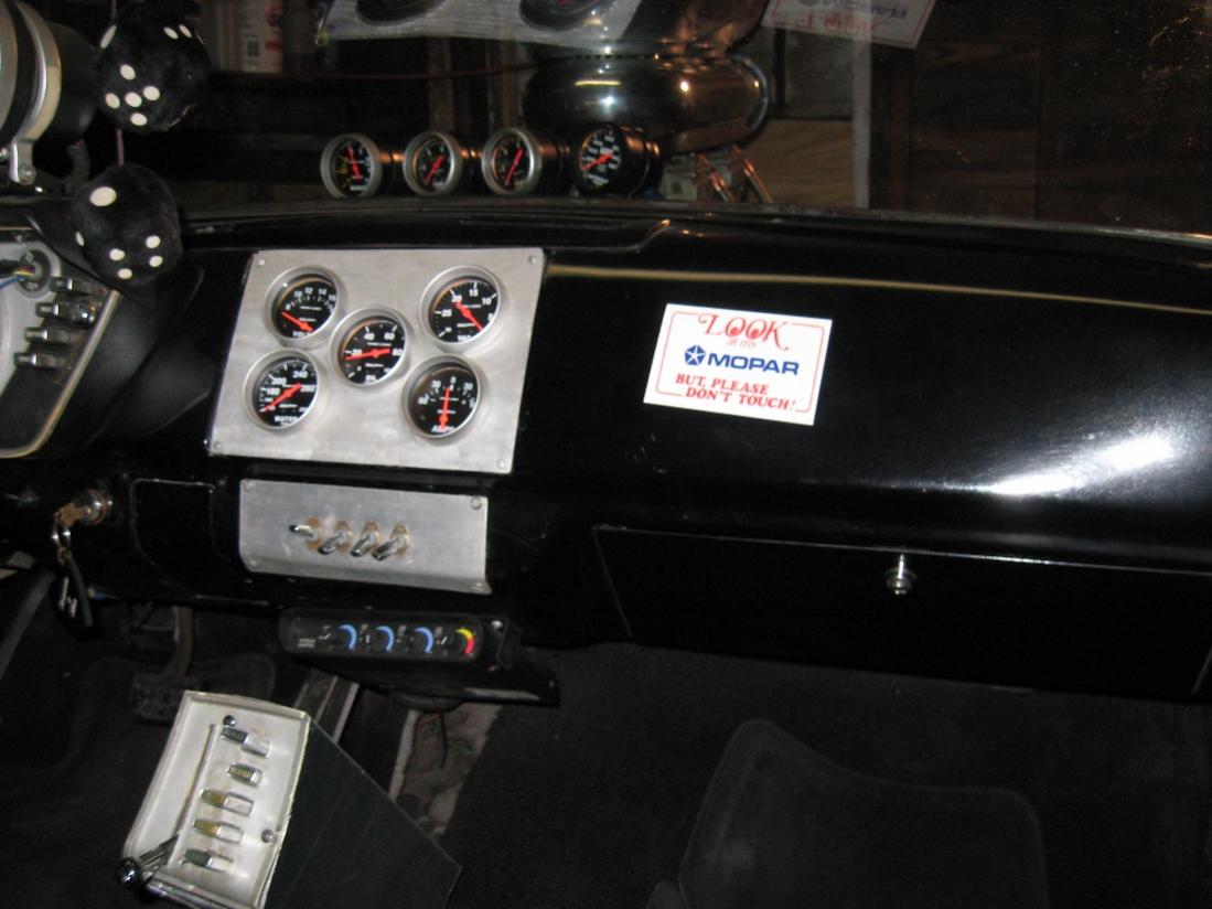

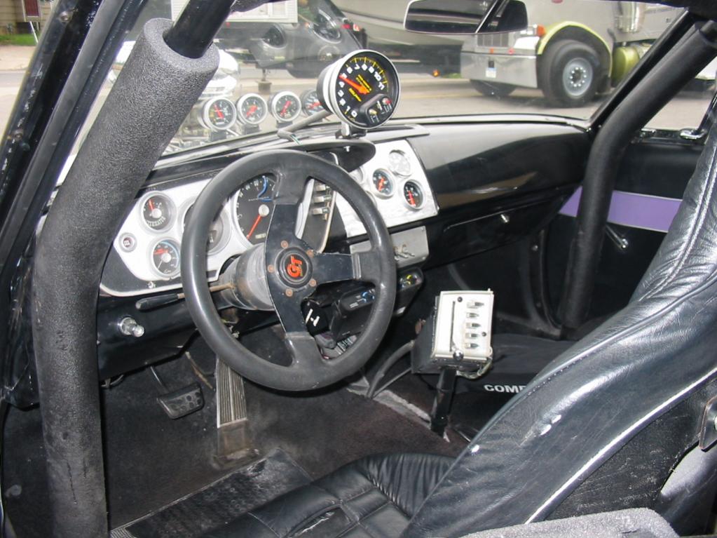

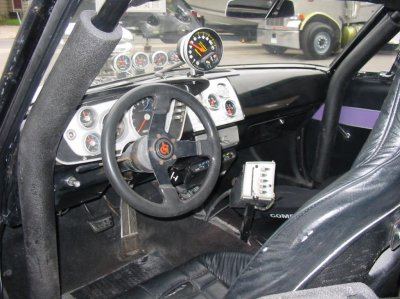

Here is another car I saw at Lebonon Valley Raceway:icon_syda:.I thought this was an Art Carr shifter,turn out it was a custom one off:icon_rambo: .Pushbuttons are what make our cars so different.I just prefer to shift with my right hand,I'm a righty:bootyshake:

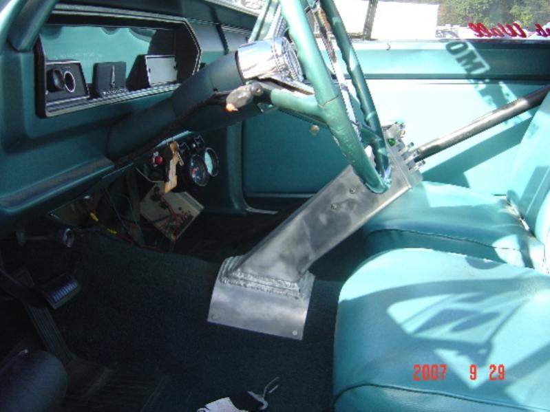

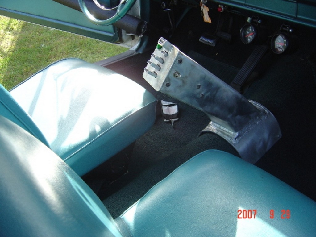

dont give up the pushbuttons. its what seperates us from the others . we are unique.
