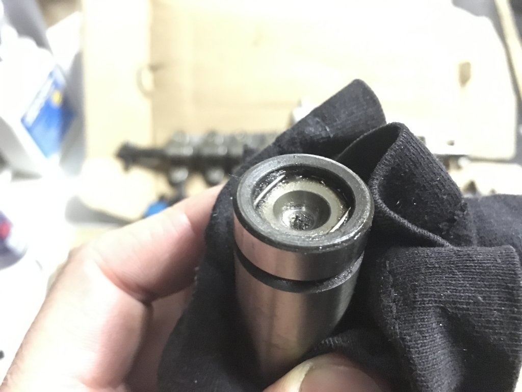

Here a pic miller, hope it helps you.
Yup! The particular lifters used make up a big difference on the outcome. You should see the stock lifters I pulled from my 440 Magnum. Cup is deep, and seems there's no spring inside!
Special tappets? Don't know, but the ones I got have a cup more like in your photo...like the later tappets Ma started installing. That's why I couldn't use stock pushrods.
