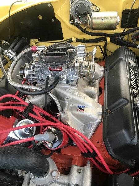

Others have used the CH4b and it works supposed to be an exact copy of an Iron intake. I know I will have to see if I have a picture of the wiper motor. This picture was before the intake swap.
That intake should easily fit under an air grabber setup. I am with the others thinking you have a 2-speed wiper motor. I have seen guys notch the base, but none of the air grabber/ramcharger cars came with a 2-speed wiper motor from the factory.
Yes no problem with the intake. Either the engine is sitting back an inch too far or his hood is out of whack. Its an AMD hood. The car is a 70 GTX I know this is not the correct air cleaner for the car but he wants the Oval one. Anyhow the car has a TKO 5-speed transmission. So I think maybe that and the transmission cross member may be effecting the position of the engine.
The pic shows the 3-speed wiper motor you need, so unfortunately that is not your problem.

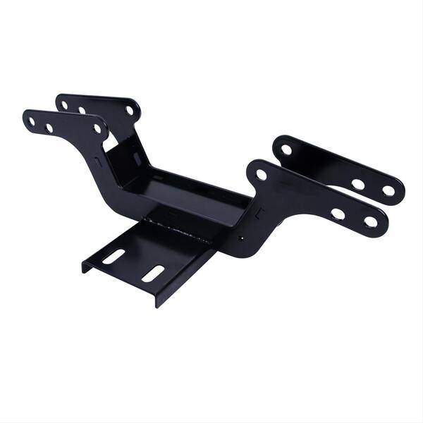

I have been looking at TKO to Mopar Crossmembers. If they installed the Silver Sport kit in the car the crossmember doesnt have slots for the transmission mount. So Im thinking its possible they have it pushed back too far. On that same note I saw another brand that had the transmount bolt holes slotted.
Here is the TKO SST kit.
Here is the other one I found.
I have that same tko kit, and it does have slotted holes for location, but you can’t move the engine with the trans mount. The engine mounts are in a fixed location. Now, if the engine mount brackets were bolted to the front of the block lugs instead of the rear, that would move the engine back.
