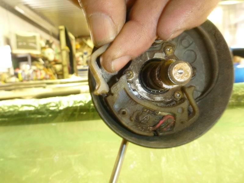

This is what's wrong with your switch...
