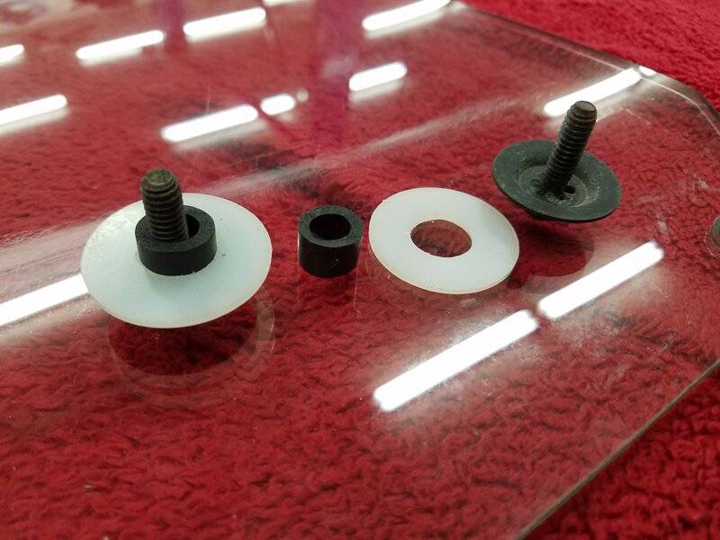

I have a 65 Coronet 2 door I'm putting back together and the quarter glass is held in with two bolts which have a bushing that keeps the bolt and glass separated.
Does anyone know where I can find them or even make them?

New or used, a Wanted thread is your best bet.
If they are the same as a 69, just cut a piece of rubber tubing that fits snug in the glass. Just did it for my Road Runner.
