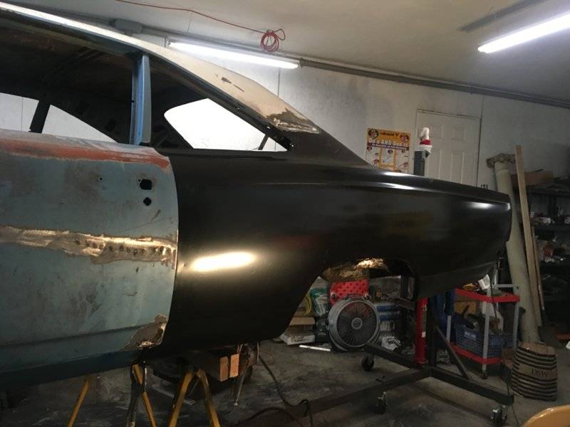

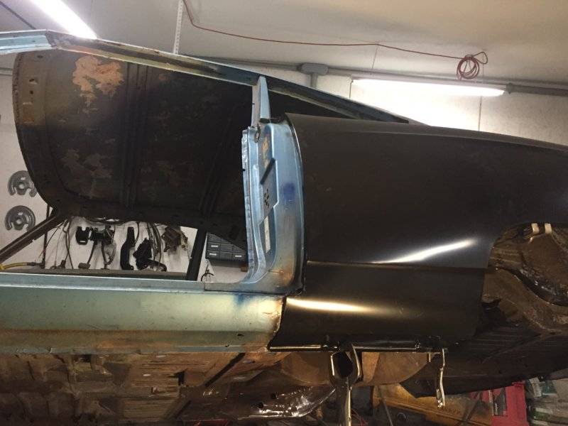

that being said, you could probably boogie a quarter on there with a drop off and some outer wheelhouse work 3-4 days...... I'd notch around the rear window; once you pull that, your most likely into a new Dutchman and it grows from there. I just did a Dutchman, 1/4 skins, drops, trunk pan, and a rear cross member; 150 honest hours working efficiently
every one of these cars is a can of worms just waiting to explode........ I gave up estimating in hours; I estimate in days, then triple it lol

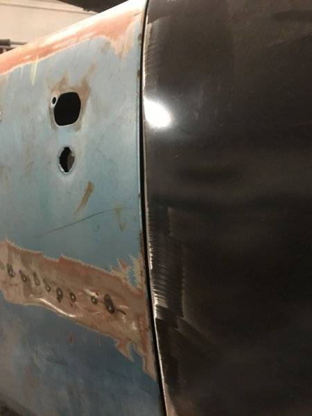

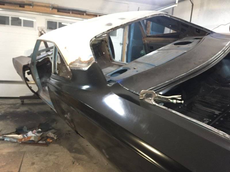

just curious, im doing same quarter skin, did you flange and overlap or Butt weld? I butt welded mine, the metal seemed thick enough to be strong enough after grinding the welds down.
yup, buttweld........ I leave a small gap 1/16 - 1/8". the weld fills it in nicely

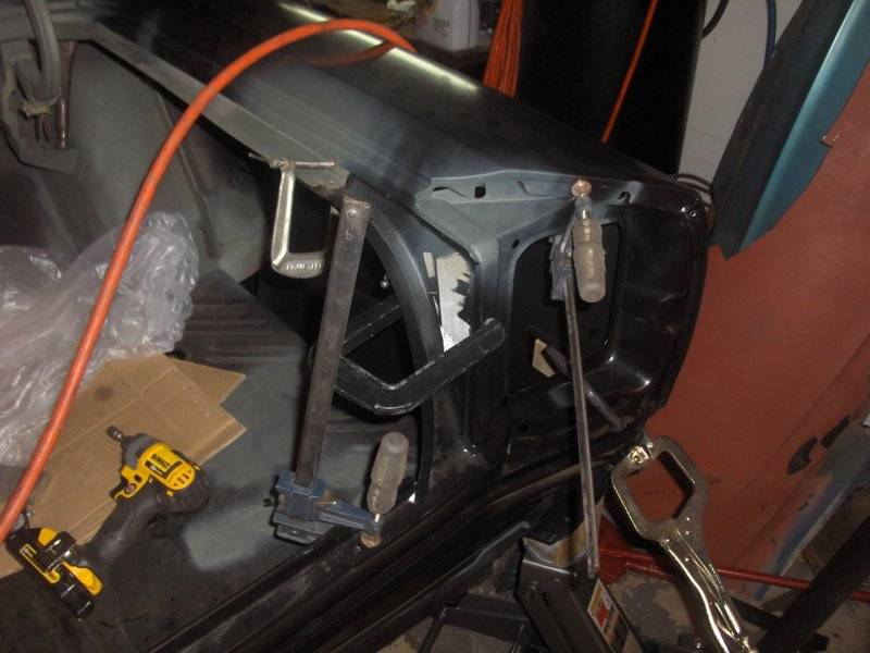

I agree with the 150 hrs maybe more. I'm OCD when it comes to lining things up. One big help was keeping old pieces that were cut off to compare to AMD metal.
