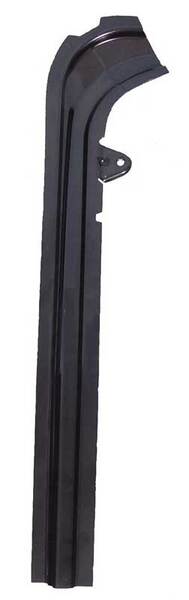

Specifically, the flange on the quarter panel that connects to the upper trunk gutter.
The trunk gutter is reproduced but has anyone found the flange available as a patch to complete a rusty gutter repair?
It would attach the quarter to the 68-70 B body gutter pictured.

Are you looking for just the curved piece? If so, just that part is not reproduced. Just get the trunk gutter section pictured and just use what you need. Keep the rest just in case you have to repair other areas. I hope I answered your question.
