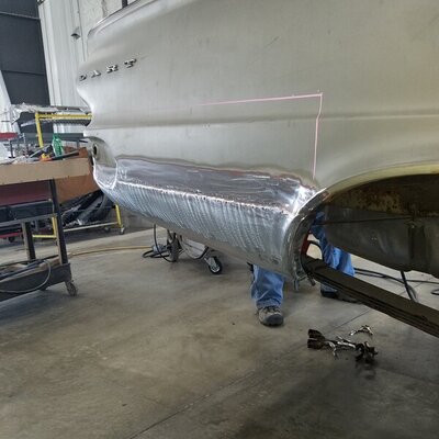

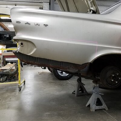

All "solid" replies here, pun intended. Simple. Keep as much OEM as possible.
Lower patch panels are being discontinued, so if you know someone with them you should grab them up. I had to purchase the entire skins to get the lower patch panels just week s ago. I agree keep as much of the original material as possible.
