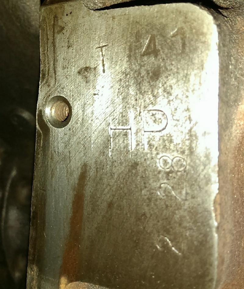

Where would I find other numbers on the block that would let me identify which engine I actually have? The owner said when he changed the oil he saw a cast date of 62 on it, but it has headers and he could not read anything else? The numbers on the pad in top front of block are a 41 by itself and a 1123 separate, I don't see the letter for the date. If it is there it is not legible. Might be an I or a T?
Google is your friend!
A "T" in front of "41" would be a 1963.
http://www.moparts.org/Tech/Archive/motor/36.html
Here's a pic of the I'D pad on a '63 413 that I have. There wasn't a letter "I" used for any years, in front of the engine size stamping. So you probably have a "T". As far as casting numbers on the side of the block, the #2205697 was used for several years after 1962. Even the 426 wedge used this block in 1964, as listed in the "moparts link". The research is half the fun of owning these cars. Lots of history!

Thanks, now that I see your stamping I can tell mine is a T. But no HP stamping :sad7:
Owner said he was told it was a heavy duty block, does that mean anything? The only stamping I have on the pad is T 41 and 1123
So if a 413 was not available in a Polara 500 in 63 I wonder where they got the motor from? I sent to the Chrysler Museum to have them send me the build data for this car so I will really know what came with it and what was added afterwards.
Not having a HP isn't a big deal. Mainly it's for internal parts, cam etc.
The engine might be from a Chrysler. Would be hard to tell exactly what vehicle. The block casting # might shed some light but they used them in a lot of applications.
