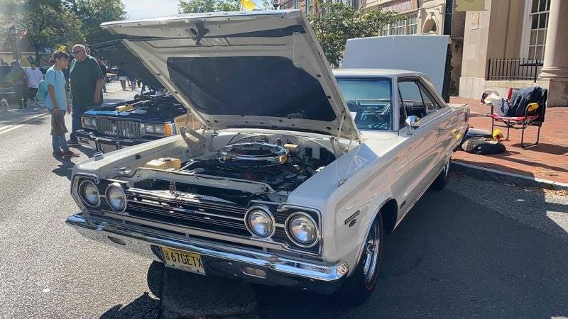

This gtx is a show cruiser , 727 auto with a 2:94 sure grip. It sees a fair amount of turnpike and parkway drives at 75+ mph. Vacuum secondary would be your suggestion? 850 too large for my combo?

I don't have much experience with the 2nd gen Hemi engine but know they pull harder in the upper rpm range and the big carb would be the one to go with if you are doing that but since it's mostly a show cruiser then a smaller carb would be the way. I still like the DP carbs since they perform very well but if you are versed well with the TQ's, then they can be your savior. Best street carb I ever had was a 71 TQ and man, it made a believer out of me. They do take some 'learnin' but they are well worth it. The Hemi is still an engine so there's no witch craft with it imo. Just gotta remember what the heads do for them.
Considering gearing and stated use: 750 vacuum.
Four gear, 3.55 rear, rumpety-rump? 850 dp
A thermoquad won't fit that intake without an adapter. Never was a fan of adapter use on thermoquads.... or quadrajets....
For your use, the cut down divider means nothing.
I agree with the smaller carb - 750 vac sec - for this application. All a DP will do in this combo is wash the walls with fuel.

A Dp will NOT wash the walls with fuel.
