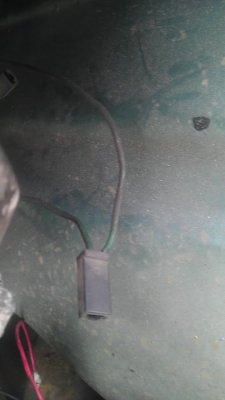

Hey man I forgot to go out and take pictures before work this morning. Give me a few and I will run out and take some pictures while it still light out.
What I would like to find is enough of the main green lead which includes the original female connector with the jumper. I could open my harness up and splice the line in and then rewrap it.
Here are two pictures. the first being the main female spade connector with the input and output wire going to the second horn. The second picture is both female spade connectors...one having the input/output and the other having only the input from the primary connector.
Thats what I need......:headbang:
