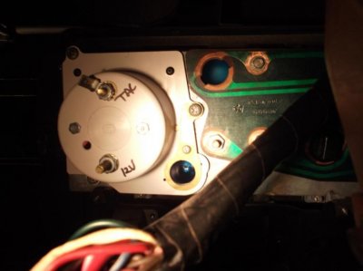

I’m installing a Tachometer into my 69RR in the das panel;
before I close everything up I have a question about the hole in
the back of the tac. It seems to have a brass flange that connects
to an install screw. Take a look at the attached photo, let me know.
The instruction (see attach photo) do not indicate what it is for.

That would be for a light bulb socket that hooks into a orange wire in the dash harness.
x2...youre also missing a twist -in light bulb in the circuit board.( the green part) . they are 1/2 inch...NOT 5/8.
The brass strip is the ground for the lamp.

I have the light bulb in the circuit board just took it our to clean it.
BUT....the tac (wiring) did not come with a light buld ...... should it have?
Thanks
You have to buy the bulb socket seperate. chargerspecialties.com has them for $10.

If you car was originally equiped with a clock I would say yes it should be there....if no clock, probably not. I honestly don't know through if ma mopar lit up the blanking panel or not.
