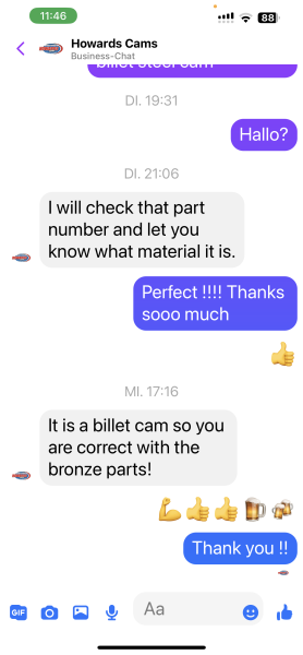

Hello, anyone knows sure what the cams are :
Howards Cams Retrofit Hydraulic Roller Camshafts 723445-08​
Billet steel or don’t ?

Email howards with the serial # on the camcard, i just did this the other day and they got back to me in a few hours.
It is a billet cam so you are correct with the bronze parts!
So it’s a billet cam

yea, it’s billet .
