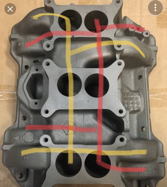

I just installed a dual wideband O2 sensor system. Innovate Motorsports. It reads the A/F ratio in real time and displays each side of the exhaust on the gauge.
My question is

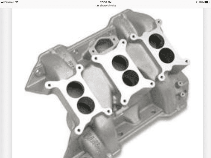

Does the Edelbrock/Chrysler aluminum 6bbl intake feed across the engine, a 50/50 mix, or do the venturis of the carburetors mainly feed the same side of the engine that they are on.
Also, is it different for the center carb vs the outboard carbs?
Thanks
Link to post in Air and Fuel systems thread:
https://www.forbbodiesonly.com/mopa...-installed-question-about-6bbl-intake.173550/
Look at your intake, it is a dual plane and it crosses over. The plenum is divided inside not open. There is a hi side and a low side, just like most foactory intakes. Look at the intake and you can see it will be 2 on each side for right side of the plenum and the same for left side.
Same for all carbs.
High side is on the right, it feeds 2358
Low side is the left, feeds 1467
