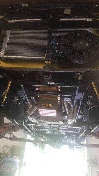

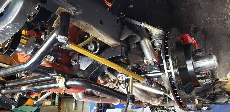

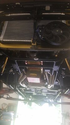

Some weight savings with QA1 K vs oem. Really cleans up the underside of the car. Strut rods are very nice looking too.
All of that!

A couple of pix of my 70 Roadrunner
