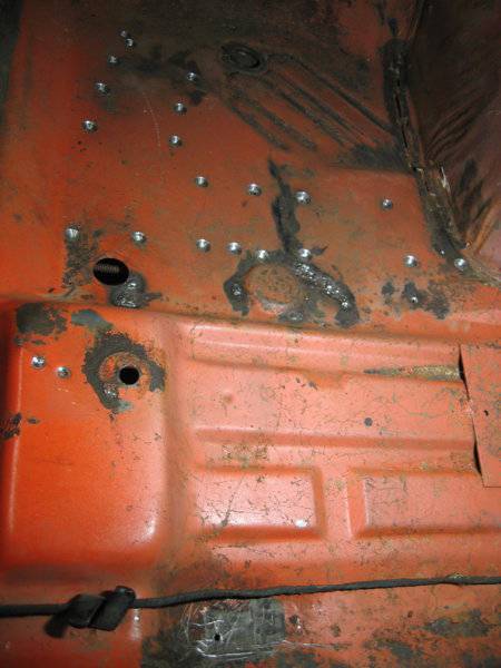

Here's a shot of mine. I also only had rot in the pedal area and I had a mint floor out of a wreck - it was even the same color !! 1) I botched cutting the spot welds out of the replacement - didn't have the right tools 2) I screwed the replacement panel in place then cut through both with a cutoof wheel. End result: the gaps were too big for comfort to weld 3) Bought an AMD floor section and cut out the whole section. BIG mistake and a whole lot of unnecessary work.
You only need to replace that pedal area ... cut the spot welds along the front and side flanges, the frame rail and across ONLY the front flange of the crossmember. Cut the old section out between the flanges of the crossmember and join the new and old sections there. The welds will be invisible from the bottom side.
