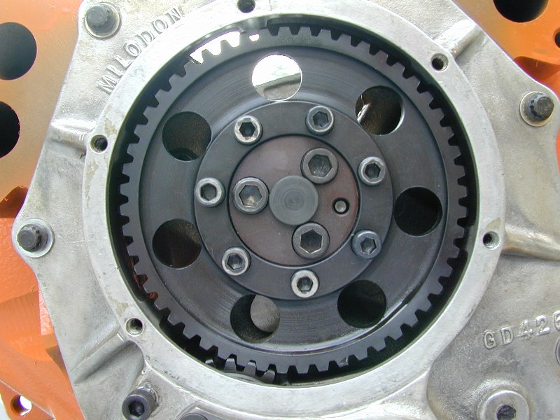

I use a siamesed MP iron block and know of a few on alcohol pushing over 1200 hp with over 1100 tq.I expect to see well over 1100 hp with my blown hemi:grin:
Thanks Mark,but those pic's are from the last rebuild.Had to sit this season out due to delays WAY beond my control:black_eye:.But some good news,I am picking up my just freshened engine up tomorrow morning,,,,,,,:grin:
