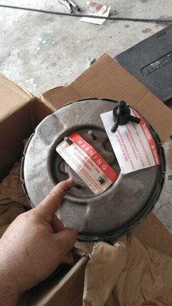

Do you have a picture? 71B used a different booster than 66-70 B. The common Bendix dual dia repo you see on ebay is what the car would have had.

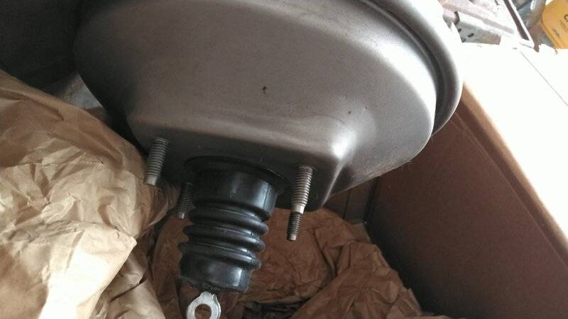

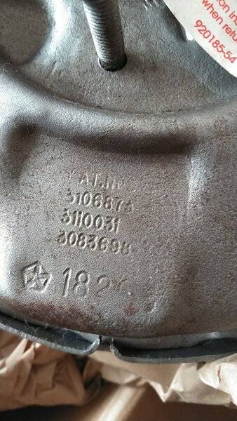

    Here’s the picture of the booster. Also I said 71 Charger, it’s a 72, not 71...
That design does look like the booster on some models 71 and up. The key is the rod code on the back rod. If you push the rubber cover down and see what is stamped on the rod, that tells what application.
Again, not correct OEM wise for a 70. The 70 service manual will show you a picture. Your booster should have 8B D rod code. It also used the bell crank linkage to attach booster to brake pedal. Reinforcement plate different also. Can you make others work, sure. The 71 up master cylinder was different also, smaller bore the the 70. Will have a small effect on brake pedal effort when combined with booster.
