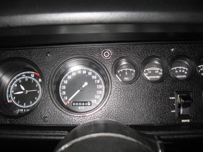

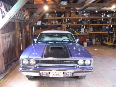

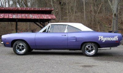

my 70 RR is stock....it has roll down windows in the back. heres a few pix to help ya:headbang:
