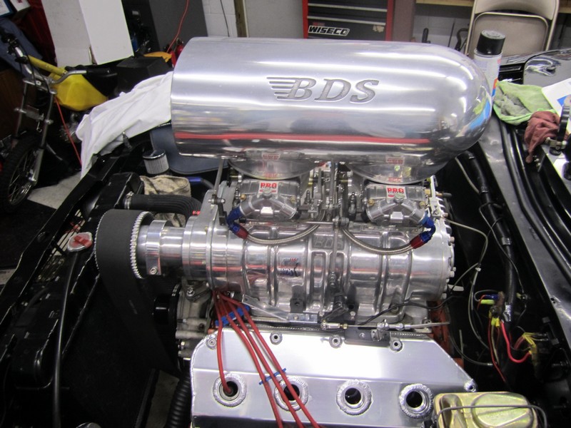

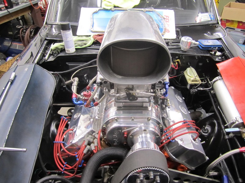

Bigger blower,spin it slower as the saying goes.:headbang:I have a 1071 stage 3 on a 540 inch hemi.10% ud gives me 5lbs of boost which equals a little under 800 HP.I can't wait to feel 10 lbs of boost!!!:blob1:
