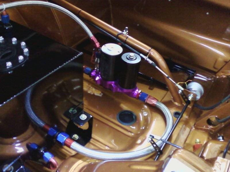

Been running 16 volt for 4 years. The fuel pump will speed up. Mine ran the pressure up. Normally it was 30 psi to the front regulator, then cut down to 5 1/2 psi. With 16 volt it went up to 40 psi. The front regulator wouldn't adjust down that far. The rear return regulator wouldn't either. Had to take it apart and cut the relief spring shorter. Everything else runs fine. It did fail a Meziere pump. Two of the wires going to the brushes broke at the brushes themselves. Put new brushes in and it's been fine. Factory late model Charger fans work very well. Cranks great on one battery. Engine is 580", 15-1, 34 degrees fixed timing, hot or cold. A theoretical properly set alternator will charge as high as 19.4 volts. MSD claims that is to high. They say to limit it to 18 volts. Until recently mine hasn't had a high enough output alternator. In fact ran all last year without one. I talked to the tech at XS battery. He said they have plenty of customers and he himself runs over 18 volts with no issue. The new alternator on mine runs right around 19 volts with accesories turned on.

Thanks for the info. A little work but I think I will put the water pump on 12v just to be safe. Interested to hear you have a regulator on the fuel return as well, if I am reading that right. I will watch the fuel pressure for sure. Don't want to flood this thing.
It has a Production Engineering pump. You can see the return line going into the top of the tank. That way the pump is never dead headed at the front regultaor. Fuel is always flowing.
