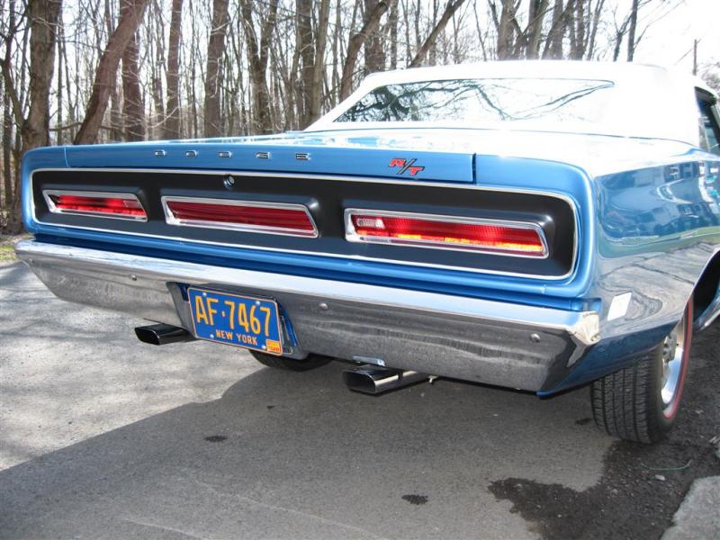

Mark,
I haven't been able to find the deck lid R/T emblem or the DODGE letters either. I don't think they are reproduced by anyone. Please let me know if you find them somewhere. I could use a set for my "twin" R/T as well. :headbang:
As for the R/T emblem on rear quarter, I am pretty sure that was only for "stripe delete" cars in '69. If you have a tail stripe, you do NOT use the metal R/T emblem on the rear quarter.

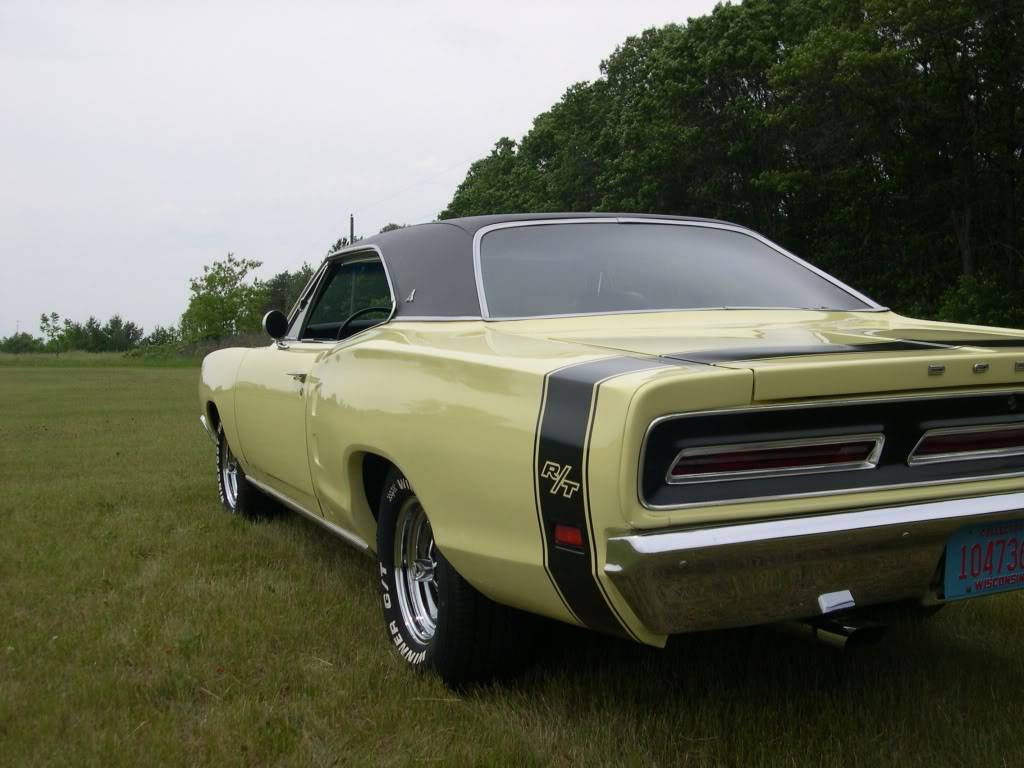

Yes, rear quarter emblem was for stripe delete cars. Here's a picture of my car from a previous owner clearly showing the emblems on a stripe delete car.

Thanks, I knew I was correct and the NOS supplier was wrong. I have a reproduction deck lid R/T emblem shipping today from Jacks Auto Parts. Jacks is a great place for reproduction pieces. I ordered them almost a year ago and he finally got them in this week. I am looking for NOS deck lid R/T emblem and the D-O-D-G-E emblems.

Mark,
Don't know if you have all the part numbers or not, so I looked up part numbers for rear "R/T" emblems for '69 Coronet and Charger.
Coronet R/T emblem is 2901817, and of course as you know is on the deck lid.
Charger R/T emblem is 2902389, and is located on the rear finish panel in the middle between the tail lights, NOT on the deck lid like Coronet's. Since the part number is different, I have to believe the two emblems are NOT dimensionally the same.
Also FYI, Coronet deck lid DODGE letters p/n's are as follows.
"D" 2784488
"O" 2784489
"G" 2784490
"E" 2784491
Attaching clips for all are 6000050
Of course these are all 40+ year old part numbers, so some or all could be superceded, and many or all could be unavailable today. Good luck with the search.

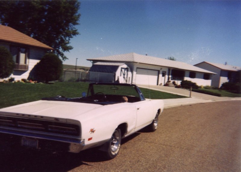

I am looking for the same items.
