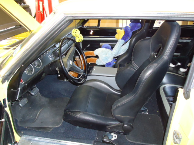

I have the cheap seats from Summit, got them $150 a pair at a swap meet, I think they are $300 new. The holes in the tracks met up with the holes in my floor perfectly, I just made spacers to get the seat level and at the right height. They are not super high quality. If I had to do it again, I would get similar seats but a brand name.
I'm about to do the same with my 69 Coronet. Do you know the hole measurement from front to back on the front seats?
My car was originally a bench seat car. The original bench seat holes were perfect for the outboard bolts for these seats, and the A body buckets I had in there before them. I had to drill my own inboard holes on either side of the hump, though.
