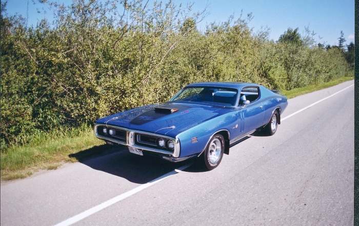

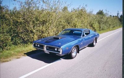

I changed the third rate BFG T/As on this car for the much better looking Polyglas GT's. It was a Hemi car so that's how I justified it but I can tell you I will never again install belted or bias ply tires on a car that I own. Simple as that. I prefer driving them to looking at them.
I'm not sure but are poly glass a bias design ?
