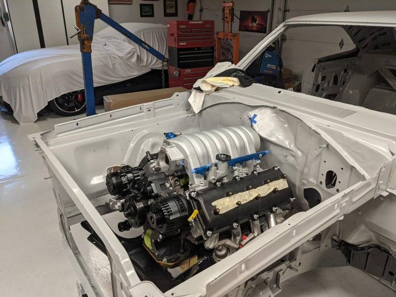

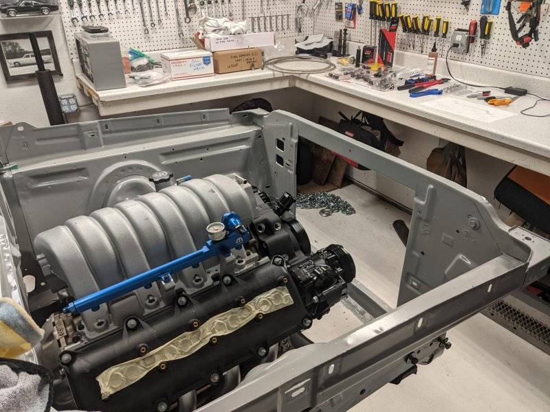

Thanks again - pictures of where it's at enclosed.

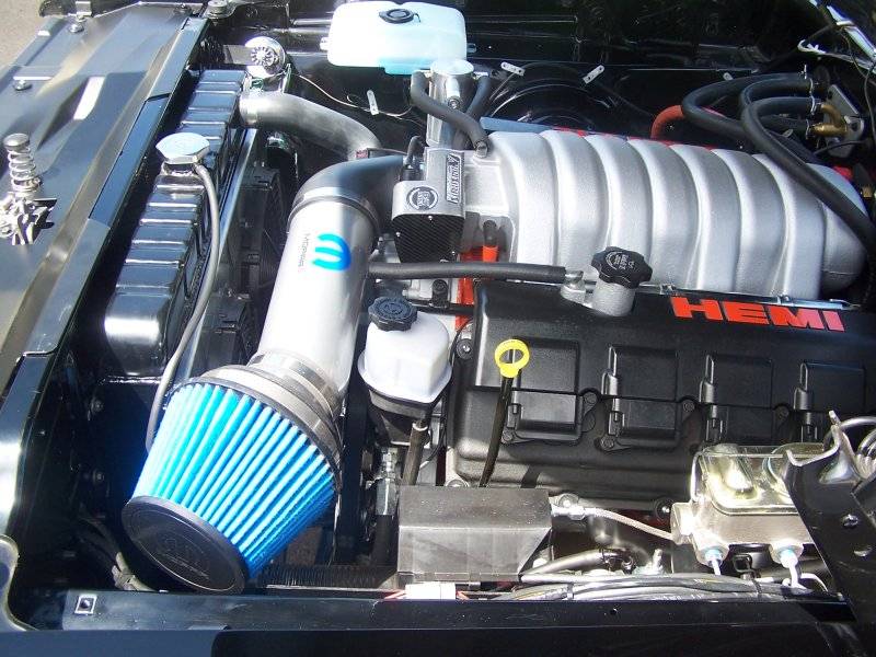

Here is a pic of the radiator I bought from Bouchillon back in 2014 for my 68 Charger with 6.1. It comes with shroud and two electric fans with wiring and trans cooler. Spendy but it does the job. My car has never went above 180 degrees even with the A/C on. It was bare alum and I painted it with Eastwood's radiator black. The fans are noisier than I would like but I'm happy with it.
