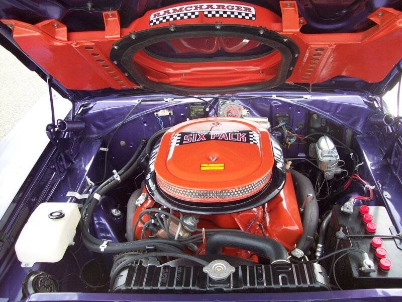

I have a 22 inch opening but a 26 inch radiator is in it. So are they saying only 440-6 and hemi got the 26 inch radiators?
Original 440-6 pack, 22” rad., 3:23 open rear.
I noticed that the 22 radiator upper hose in on the drivers side and the 26 radiator upper hose is on the passenger side.
Is that the factory radiator or after market, does it run hot,here in s carolina it gets smoking hot and humid. I want to install a 22 inch.thanks Dave
Factory rad., never gets hot. Had it out in 90+ degrees. Any hotter than that and I overheat.
Engine has higher than stock compression (185 cranking pressure).
465 hp, 512 torque, VP 110 octane. fuel.
