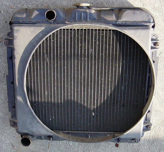

Here's an 053 radiator with 130 shroud from a '69
