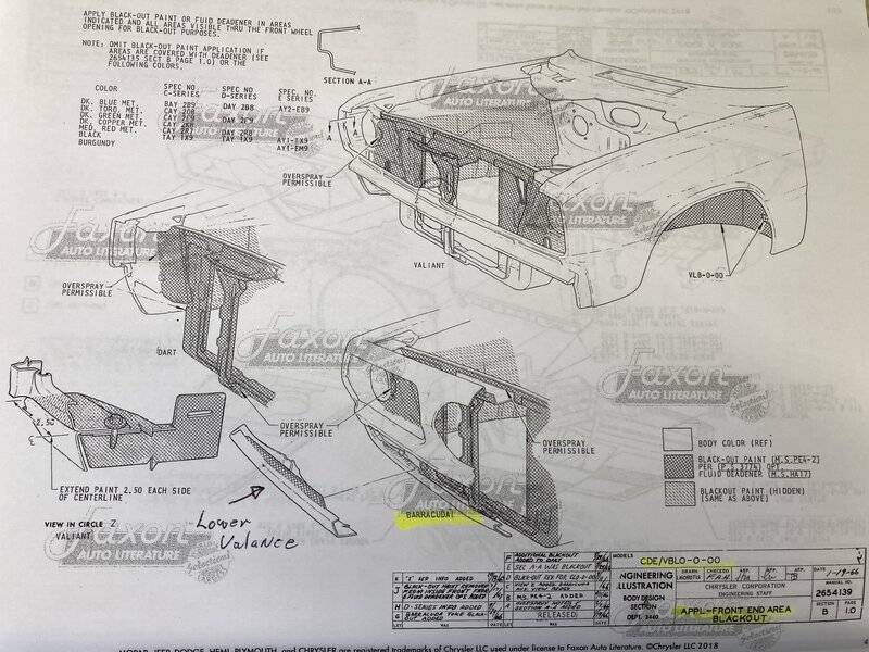

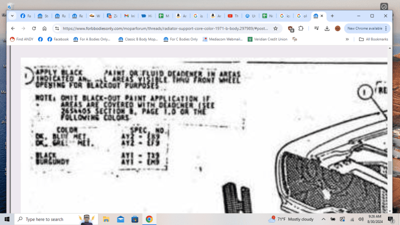

As promised.
The first one looks like a B Body (70 RoadRunner) and the second is an A body. Interesting the A bodies have a longer list "Not" to be painted. Cost savings?
B body says "Paint with paint or fluid deadener" A body says just "fluid deadener". I am guessing it's thinned down undercoating. That's what it looks like color and texture wise but it isn't thick like undercoating is. It would have to be thinned to be sprayed out of a wand.
