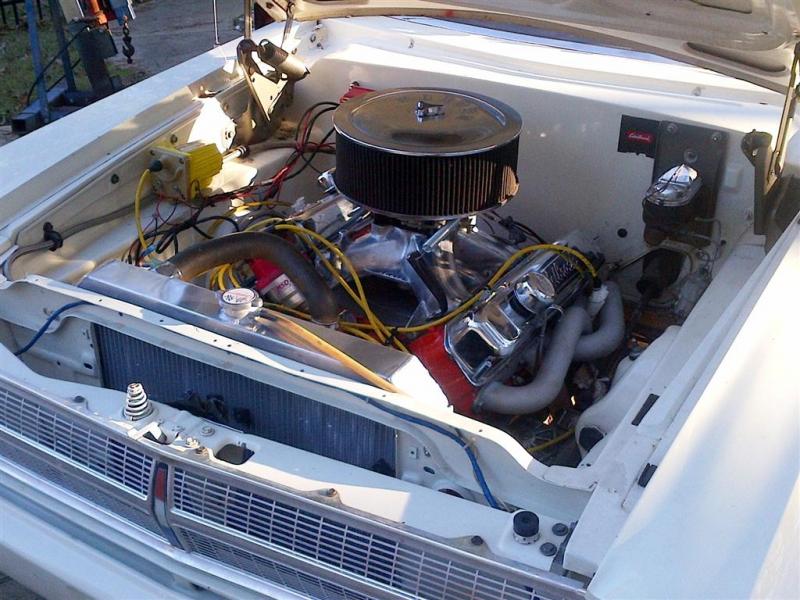

I have a champion in my car with the 500" motor.. it is the 3 row and stays dead on 180... I bought mine off of EBAY and got it for 185 plus shipping. Very fast shipper.. I have the 26" in my car.

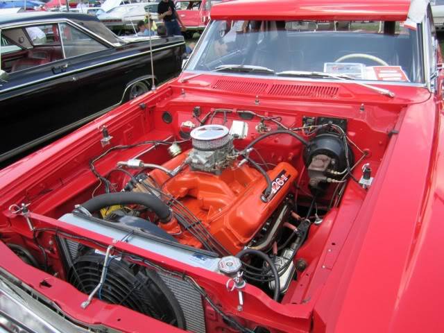

I put this Afco rad in my 63 I bought from Mancini for about $329. It fit right in and had the mounting brackets on it but with no holes. I just lined it up and drilled the holes in the brackets on the rad. Then bolted it in. It has the lower hose on the drivers side and cools just fine. I added the fan on a toggle switch in case I would need it if I get stuck in traffic. Ron
