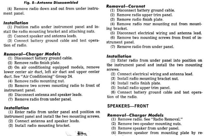

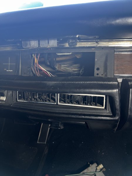

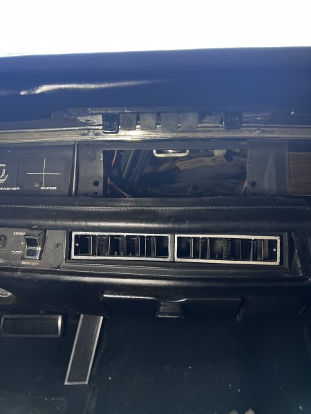

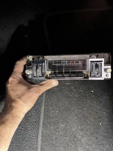

Hi everyone I was wondering what’s the best way to install my radio
You may have to pull your glove box out to get behind the dash. More so with A/C.
Glove box can stay. This is 69 Charger and Coronet which will be the same for all 69 b-bodies
I also found cussing the same word 4 times and one leg cramp was also involved. :bananaweed:
If you need to replace your glove box now is the time.
That center vent comes out pretty easy. Must come out. It can be a pain to install the antenna wire. Be sure to go ahead with a new speaker while there. Be sure it has the correct ohms or you’ll burn out the transistor. Sm Electrotech has what you need. I did this job a couple years ago on 69 GTX with ac.

Old thread, but shouldn't the 2 face bolts be tapered, vs hex head?
