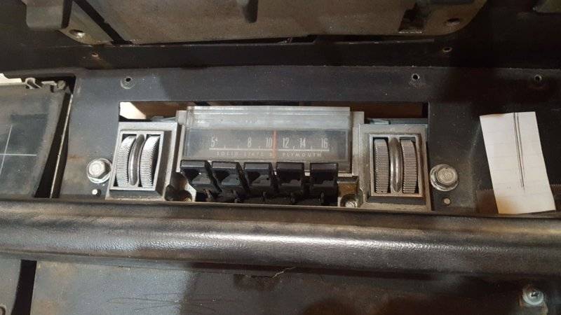

Close. It's actually two flush-head screws on the front, underneath the woodgrain faceplate.

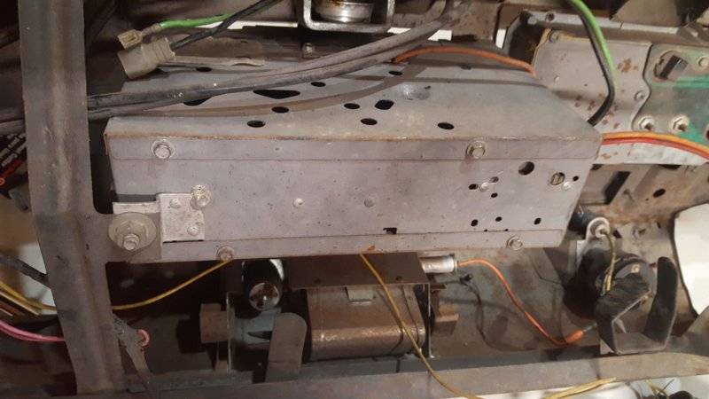

There is also a nut on the backside that mounts the radio to a metal brace hanging from the dash structure.
Two wiring plugs - one for speaker(s), one for power, both coming off the left towards the steering column.

Yeah, they use the recessed head screws on these that fit flush down into recesses in the dash framework - I assume
to totally get out of the way of the woodgrain faceplate on top.
Please be very gentle with the plastic radio bezel.

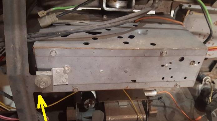

So we're going to ignore that you also have to remove the antenna plug at the rear lower corner on the right hand side of the radio unit??
Located behind this mounting tab (yellow arrow).
Yes I was wondering about that one. That said thanks to all that participated and the pictures. I plan to replace/restore mine this winter so it was a big help.
