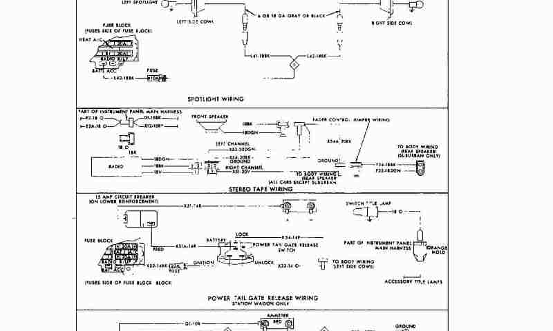

Jessipup, I'm glad you couldn't find them on the schems because I couldn't find them on there either. I thought I was going nuts, but it looks like the radio was left off the wiring diagrams for some reason.
That is correct, the original radio wiring does not provide for an “unswitched” power supply. The closest/easiest connection will be at the fuse panel “batt” tap if it is available. Cigar lighter is another nearby unswitched power source or the pink three-way tap close-by.
notations are for another thread.
From the 72' FSM;
Hey 72 That's a sweet diagram you have there. I have diags pulled from my mopar, Haynes, Also books with no diag- 73 parts book again from mymopar, 74 body service manual and a parts interchange.
But nothing like that. Please assist me with a correct title of one of those for a 74 Sat/Runner.
:icon_study: Must have more books, Must have more books :icon_study:
The quest begins.
Thank you.
It’s from a CD copy of the 72’ factory service manual; I would expect the wiring diagrams in the 74’ factory service manual to be similar in detail.
