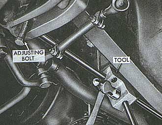

Where exactly is the nut that I adjust? Is it the kind of long vertical bolt, points upward?
^^ Yep. Here is a pic from the manual to give you a visual.
Thanks, yea I figured it out, what a piece of cake. The bolt was clean and turned effortlessly.
