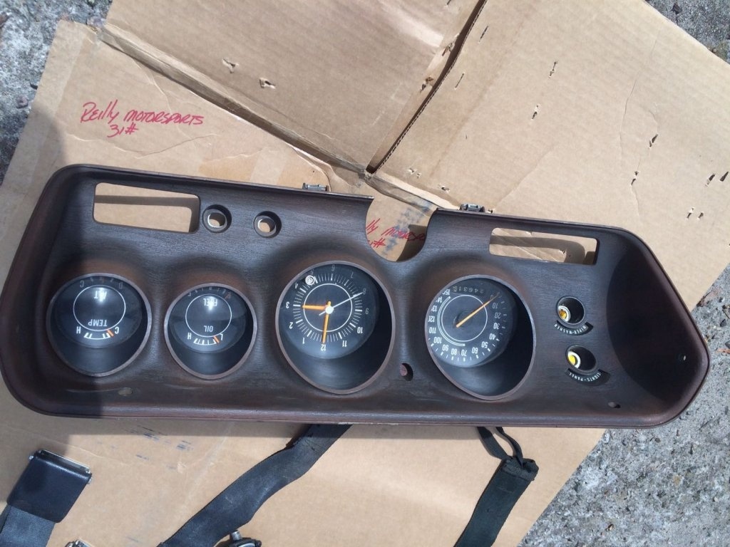

Does anyone know, if this Ralley Dash fits in a 1973 Dodge Charger?
It seems to be from a 1971.
And is it possible to replace the clock with a Speedometer?
Thanks
Axl
71-74 dash bezels all had the same mounting points so they interchange. May be differences in the wiring though. The clock can be replaced with a tach. Not sure why you'd want two speedometers.
As stated above yes and yes, but you'll need the proper harness for a 73-74 car they had more crap and wires under that dash .
Thanks for your help.
It´s a little bit confusing because in german the instrument wich shows your speed is called "Tachometer" and the instrument wich shows your RPM is called "Drehzahlmesser". And that the instrument I would like to put in the dashboard instead of a clock....
