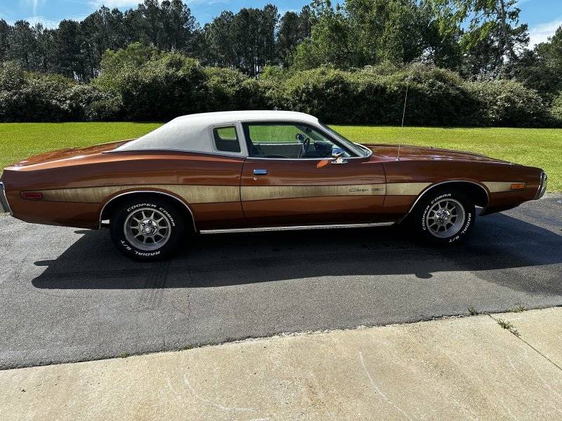

Thinking of adding this 73 rallye hood to my 74. I know it's not correct for my 74 and might catch some flack for it but I am running a Ed rpm air gap on a 360 and it fits barely without a carb spacer. I tried a 1/2" and it rubs the insulation. A one inch would be ideal to balance out the flow. some people cut out 1" in the divider on the intake. I thought about a low profile air cleaner but have run into clearance issues with the electric choke on some of them. Anyway I love the look of these hoods and think is adds to the body lines.

Even if they gripe about it, it's YOUR car. I think it would look cool. By the way, I love those rims!
