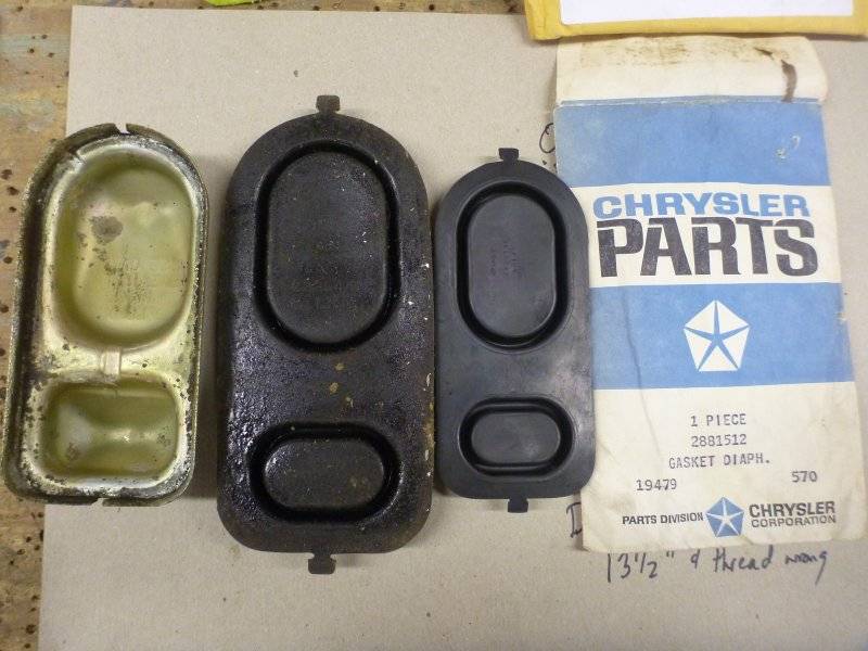

Only "example" I have. This is a brake reservoir cover that was running DOT3 for 40 years and someone thought a quick top up with power steering fluid wouldn't hurt anything... maybe something the "enlargement" folks want to look into!
