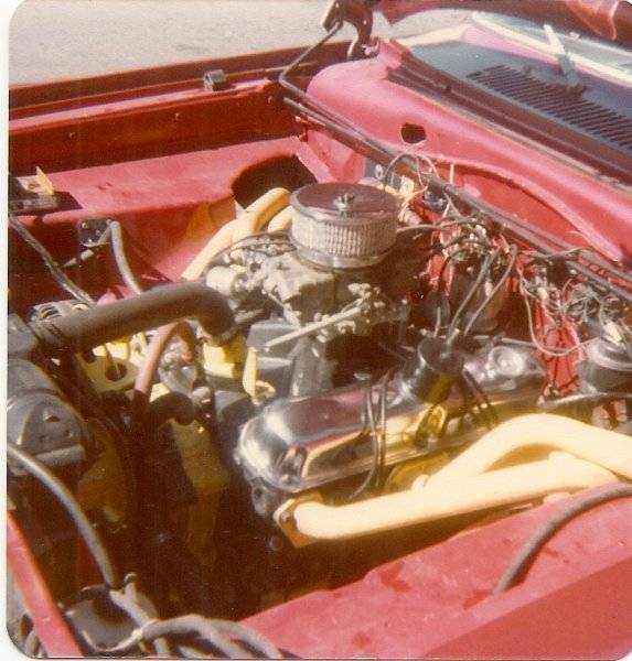

Back in the 1970's I remember re-torquing the steel shim head gaskets on a 273 build after the first cool down period after breaking in the camshaft. I did not loosen the bolts, only re-torqued them as they were.
I read online today that when re-torquing, the bolt should first be backed off a bit.
Not sure what is best. Probably boils down to who you talk to.
