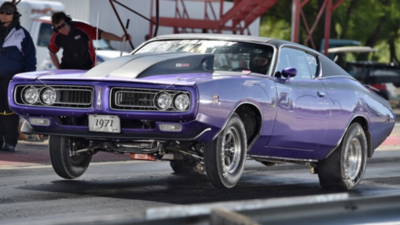

I have a 71 charger that will be a street/strip car and I’ve heard these cars are pretty heavy. I would like a goal weight of around 3500lbs with half a tank of gas and no driver. Currently has a 440 with aluminum heads, intake, water pump housing and headers. Currently has weld draglites, Interior will have two plastic bucket seats and original dashboard, no heater box and a fiberglass hood. I’m I being realistic with the weight?

So I see in your picture your car is a sunroof car . Is this the car in ? As that sunroof stuff is extremely heavy but the car isn't that bad people say there a few tons witch is not correct 3800 sounds correct for a 440 car I'd say that sunroof stuff might add another 200 #'s if it's factory stuff if it's aftermarket pop up then never mind 3500 is a easy goal to get to
My 72 4 spd GTX weighs 4050 with full tanks of fuel. Sitting as shipped from the factory w/o a/c.
It’s some aftermarket thing someone added years ago.
