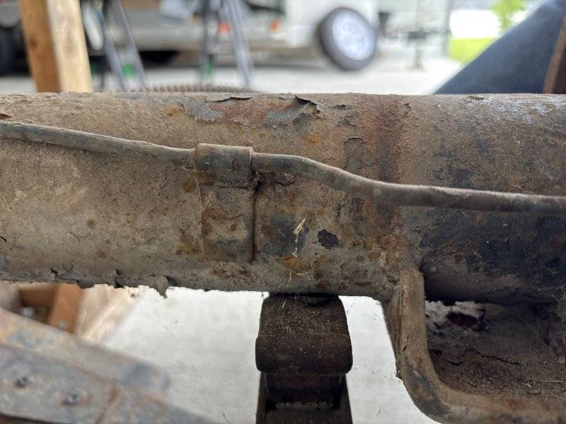

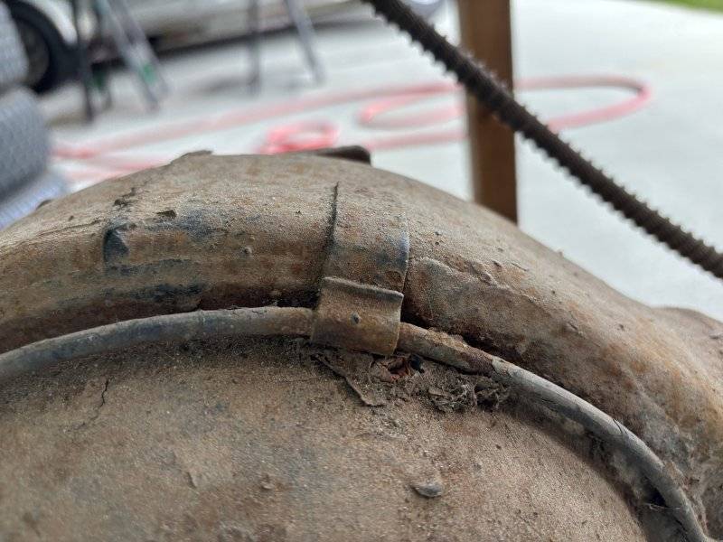

Does anyone have the quantity, type, and location of the brake line clips that are welded to the rear axle? I have 1 that's currently in place and what looks like 2 other locations where they "may have been" at one time. I'm going to remove the diff and axles for rebuilding/replacing bearings. I plan to replace (weld) any missing brackets while it's empty and before it's blasted & painted (possibly powder coated).

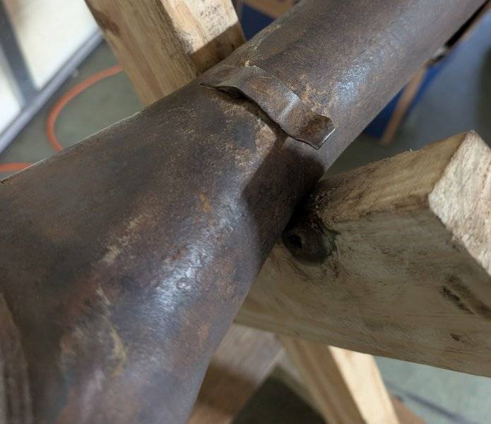

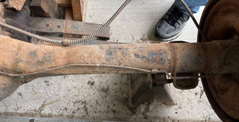

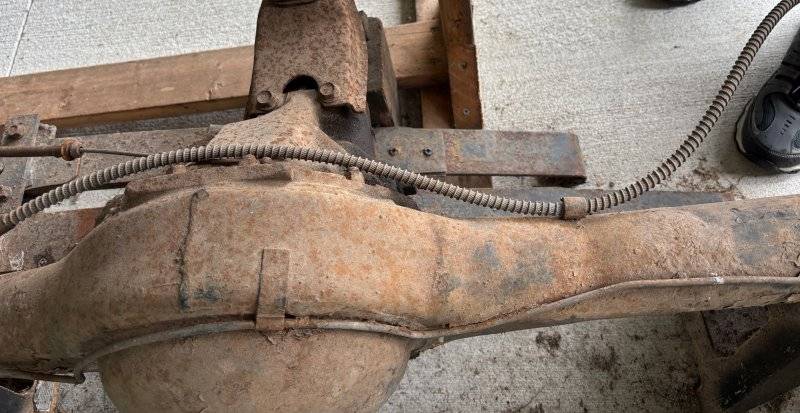

Another possible clip location on pumpkin and another close-up of the one remaining clip.
If anyone has a survivor and a has a couple pics, please share. Since I have nubs where they might have been, just confirming location and style. If they all look like my one remaining, I'll hunt for them.

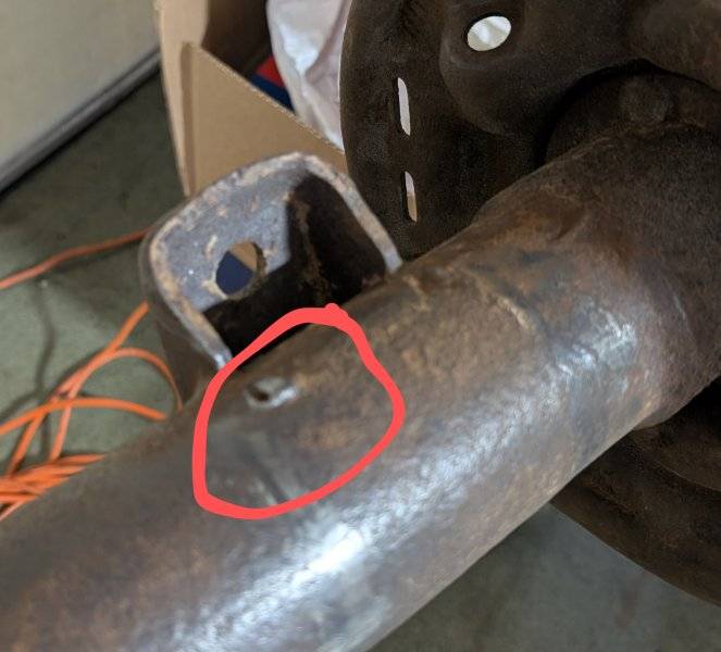

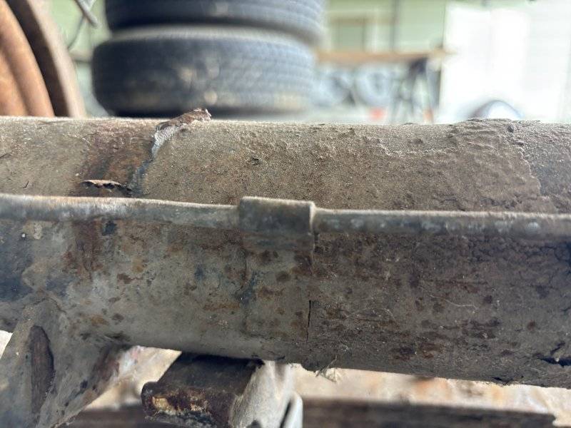

There are three. One near each spring perch and one at the top of the housing. Mine is up against a wall so kinda hard to get behind it.

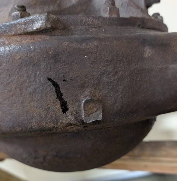

I don't have that one right above the perch. Looks like maybe a spot of welding slag on yours.. The U-bolts is right next to it.

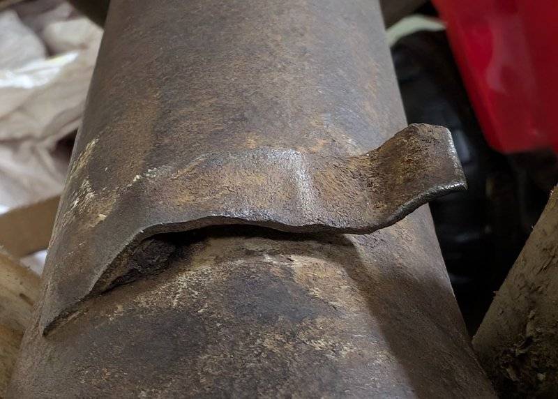

I was thinking it was welding slag, but this one on the passenger side of the pumpkin looks different than yours - right?

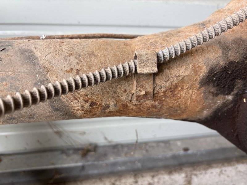

Or was that end piece supposed to be bent back over the brake line? IIRC the brake line was running under that piece and held again the axle.

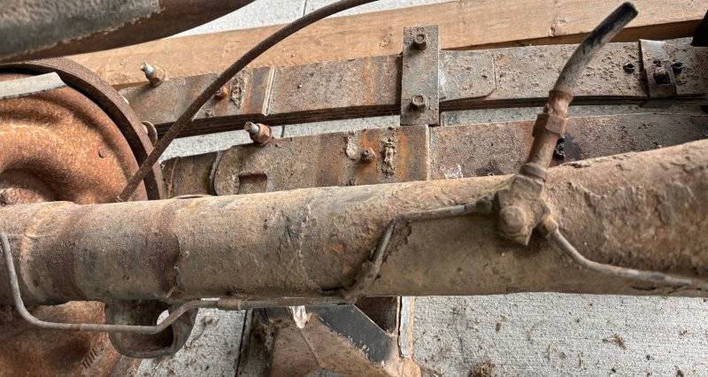

E-Brake cable. See my top pic.
Pic of that from the front.
