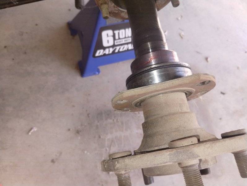

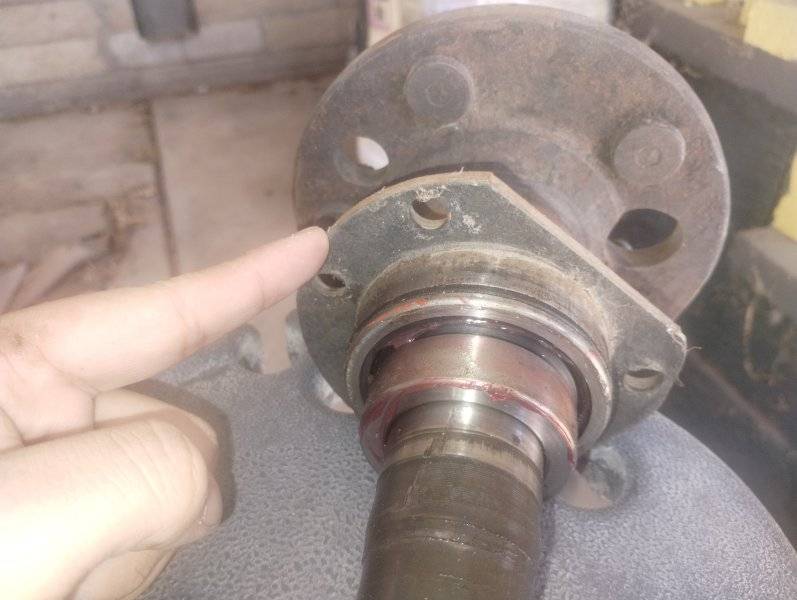

Hey everyone, I wanted to ask about parts to the rear axle for my 67 Charger.
I'm in the process of doing a rear disk brake conversion and want to make sure I'm not missing any parts, and which parts are which so I can replace anything that needs to be replaced.
So the thing that I have my finger on is metal on the one side but it feels like it might be plastic on the other side that is black. If anyone can tell me if this the whole thing is some kind of gasket or if just the black side is I would be incredibly grateful.

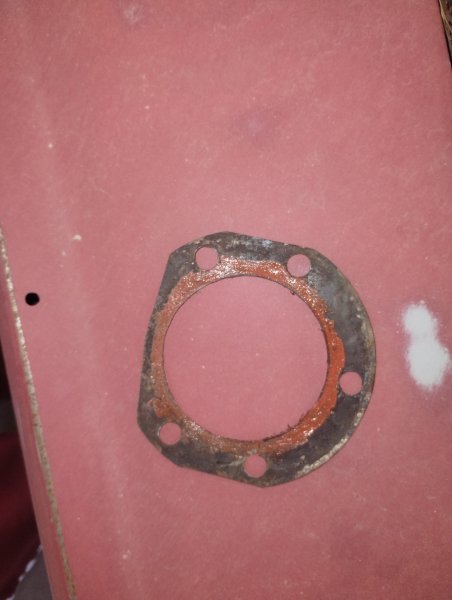

The thing that is on its own on the red background is a gasket, unless I missed my guess and I was hoping someone can tell me if this gasket and sealing kit is what I need to replace the gaskets on the axles. Also if there's a different kit that anyone can recommend that would be awesome too.

Just a foam gasket on the retainer plate.
Beware some rear disc brake conversions require you to replace the axle bearings with non adjustable “green” bearings.
If it were me I would consult and source everything from Drdiff , that way you know everything will work together with no issues.
First pic is axle retaining plate. Gasket on the housing facing side. The gasket kit you posted should be what you need.
The link you posted with the retainer and adjuster...should be on the other side of your axle. This is an 8 3/4, correct?
Earlier taper axle 8 3/4" rear ends used shims under the retainers, not an adjuster, so both sides looked identical.
Can you get a picture of the other side?

You do not need these unless you switch back to tapered roller bearings, it appears someone already installed the green bearings.

I would replace the bearings while I was in there. The green bearings you have aren't that expensive.

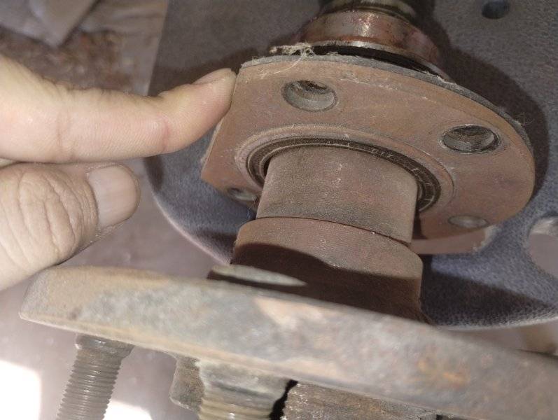

So here's what the other side looks like. Like others have said, it looks like it already has the green bearings installed and the description of the bearings said they're meant to eliminate the need for the retaining plate.
There is no endplay in a ball bearing but, a tapered roller must be adjusted for proper life, hence the OEM adjustable retaining plate on one side (right side). Left is fixed. Tapered roller bearings are optimal for side thrust, balls are meant for radial thrust with light side thrust

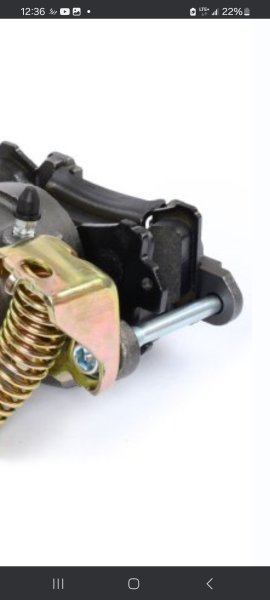

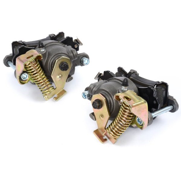

Basically, is the caliper a fixed position with the pistons on both sides of the caliper? Or is it a floating single piston caliper. The latter would lend itself to factory bearings
So these are the calipers. From the instructions, it gets bolted to brackets and stays in one place
So does that mean I need different bearings? If it does, can you point me in the direction of a kit that has everything I need?
No, the ball bearings will work. They are just not optimal for hard cornering.

I believe the "green bearing" tag was because of the green grease seals used originally on the bearings. They were ball bearings.
Some disc kits needed the fixed rotor position they provided; others did not, so the OEM tapered design would work.

It appears all 3 bearings you show are all ball bearings so, any should work with the calipers you chose.
